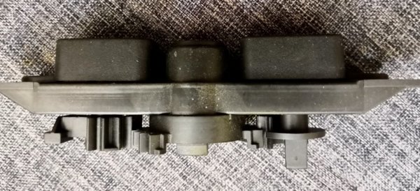

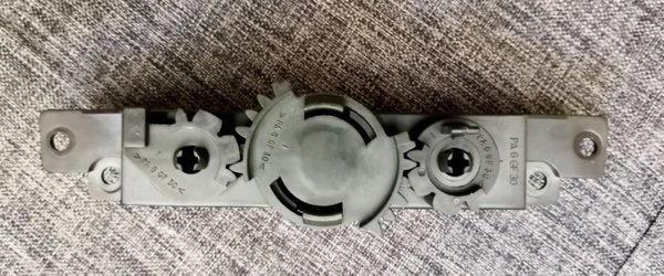

The rear storage compartment on the Z3 has a key lock that utilises the ignition key from new. When upgrading between standard and roll hoops fitments there is a way to change the key locks.
On either of the storage compartments you need to get to the locking mechanisms. These are accessed by removing the inner part of the compartment.

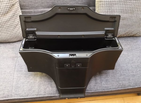

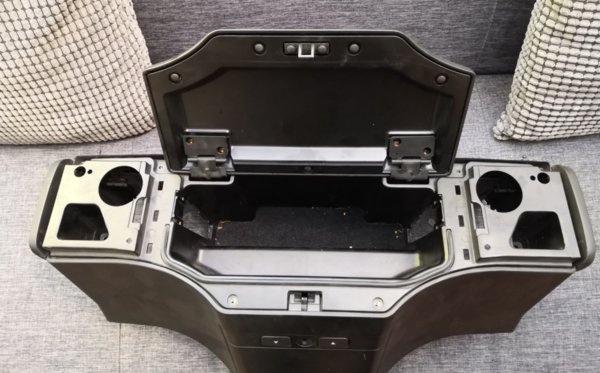

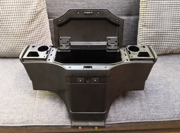

The four pics show the two style/sizes of compartment. Both of them have hinges for their lids which must be removed by taking out the four screws (hidden under black blanking covers).
