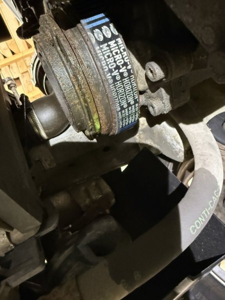

Anyone got an aircon compressor,in excellent condition.
BMW part number 64528391474,think make is Seiko Seiki

Existing one has leak looks like pulley seal.
How did you sort different clutch issue ie swap clutch over or did 2.2 pump swap over as is

However, I have transferred the 2.2 compressor onto my 2.8 and everything lined up perfectly physically.
The only difference I found was the black trigger wire to the clutch has a different connector, so I spliced a new connector from my donor car to my own car. So I see no reason that it will not work. (I did not change the physical clutch).
I am not able to test it and prove it works until the system is re-gassed and has pressure, as there is a fail/safe pressure switch that prevents the clutch pulling the pump into action if there is insufficient coolant in the system : otherwise it would burn the pump out.
I hope to have my system up and running in the next week / 10 days so will let you know.
Essentially if you find a pump for sale ask for the car loom electrical plug that goes with it.
