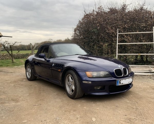

Ok so I thought I’d start a thread.
Spent the last year or so working to get her back on the road.
Bought March 23, never bought a BMW with full service history and low miles (113,000). Well that bit me in the arse.
most recent photo added

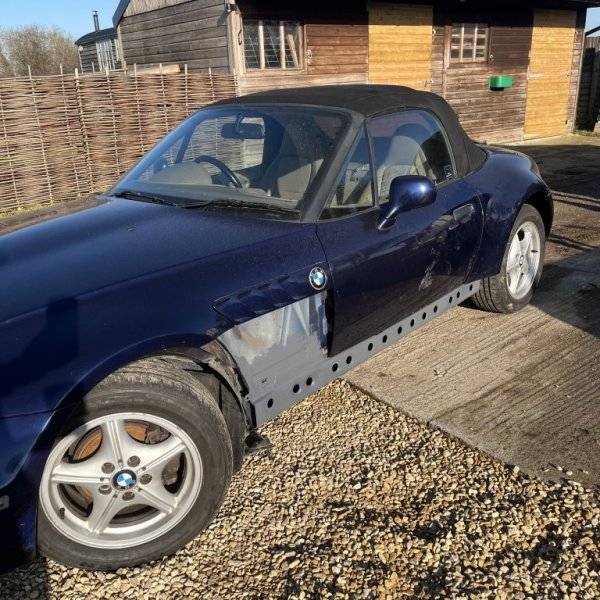

When I first got the Z3 home. There was the odd issue like leaking rocker gasket and usual older BMW plastic failures. And the radio only played classic fm.
then it started smoking a little, until finally the head gasket failed. No over heat, no mayonnaise on filler cap, just oil in the radiator.
I was gutted, one of the reasons I wanted a Z3 was my mum had had a blue one for years, and if she ever had the radio on, she would only ever play classic fm 🙂

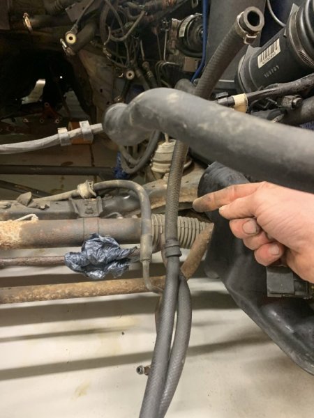

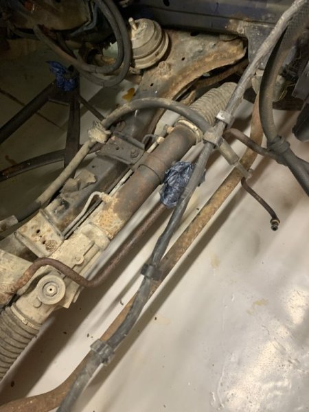

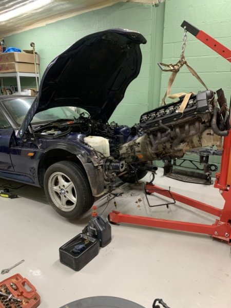

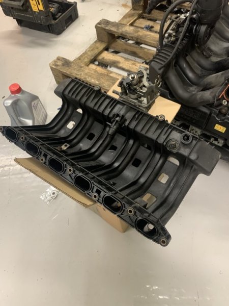

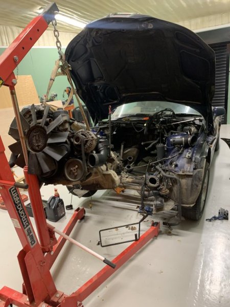

A replacement engine was found and so the process began. I picked up a bare unit, with a m50 manifold thrown in. Out with the old.

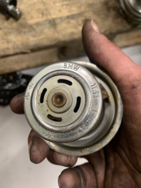

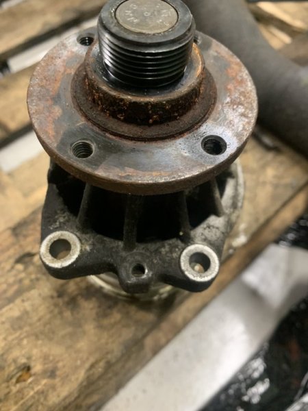

Swopping parts over concluded who ever had serviced this car hadn’t replaced a few bits. Reckon that might be the original thermostat. Not sure about water pump as it was a metal type.

Look at that lovely clean floor!

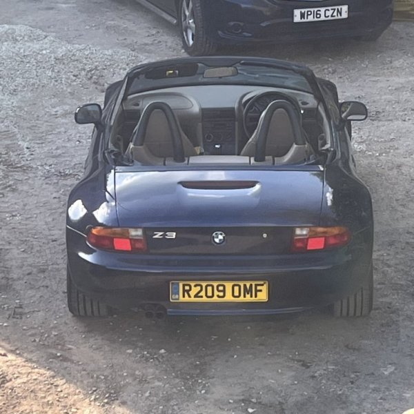

After all the work I’ve done on this car, I still don’t trust it. So today was shake down day!
Filled up with a tank of super unleaded and head on a road trip/pilgrimage to Northamptonshire.
A mere 200 mile round trip.
Me and the boy had great fun and the car performed faultlessly.
Still a big list of things to sort, but finally can use it!
over took the Porsche on the dual carriageway round Cirencester 😎🤘
Do you feel you can trust her now, she didn't miss a beat for 200 miles :thumbsup: :thumbsup:
